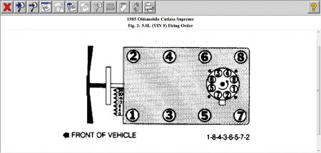

I replaced spark plug wiring and messed up the wiring
Jul 30, 2010 at 9:42 AM
  • 75,992 POSTS
No problem sir -here you go
https://images.2carpros.com/forum/automotive_pictures/12900_fo_137.jpg
