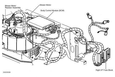

I have a 2003 Olds/alero that the heater blower motor only works on high. I read that it could be the Blower Motor Resistor and if so how & where is it located?

Hi: Yes, it sounds like the resister. Here is a picture of it's location under the dash (below right side).
https://images.2carpros.com/forum/automotive_pictures/249084_Graphic_6.jpg
I hope this helps and have a great Christmas. Joe Positive feedback is appreciated.
