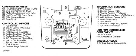

I think I have a fuel pump relay problem but I am not sure where it is. I found a row of 5 relays behind the right headlight and two to them are the correct type but I am not sure if either are the fuel pump relay. I have replaced both of those with no success. Where is the fuel pump relay located?

on relay bracket, in the right front corner of engine compartment.

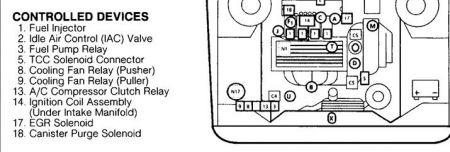

Welcome to the forum, underhood, passenger side front, relay pack. I don't know if you can read that? It's number 3, relay closest to radiator. Double check by looking at the wiring colors at the connector. red-- gray-- orange-- dark green wire with white tracer-- black wire with white tracer.
