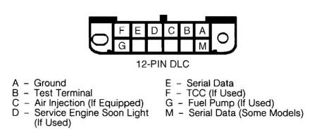

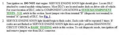

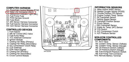

1994 Oldsmobile Ciera 6 cyl Front Wheel Drive Automatic
my 94 olds cutlass ciera has the check engine light on, and I was wondering, to rerieve the codes on this OBDI style , to have the check engin light blink the stored codes at me, do I just turn the key on and off 5 times, or do I need to jump pins in the DLC, and which ones if so?

https://images.2carpros.com/forum/automotive_pictures/261618_Noname_393.jpg
https://images.2carpros.com/forum/automotive_pictures/261618_Noname2_110.jpg
https://images.2carpros.com/forum/automotive_pictures/261618_Noname3_52.jpg
Let me know if you need further assistance.. Thanks for using 2CarPros.com!
