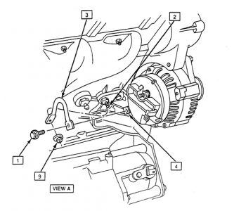

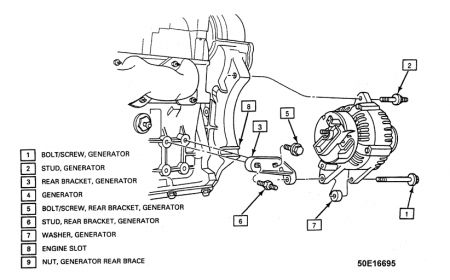

Nephew dis assembled the alternator and power steering brackets... of course he can't rememeber which bolts or exactly how these are bolted up. Does someone have any diagrams that will help me out?
May 11, 2010 at 3:58 AM
BLUELIGHTNIN6
  • 16,542 POSTS
Hello and thanks for donating Let's see if the diagram below helps with the installation of your vehicle's alt. and bracket assembly. Let me know if you need further assistance.

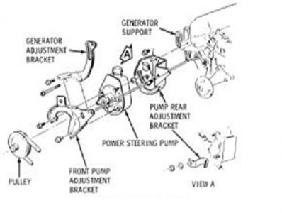

Thanks Do you have the diagram for the power steering pump too
May 11, 2010 at 11:31 PM
BLUELIGHTNIN6
  • 16,542 POSTS

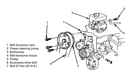

oops, sorry i forgot that. not sure if you have the 3.0L or 3.3L so i posted both below.. 3.0L Power Steering Mounting
https://images.2carpros.com/forum/automotive_pictures/261618_Noname_2149.jpg
3.3L Power Steering Mounting
https://images.2carpros.com/forum/automotive_pictures/261618_Noname2_697.jpg

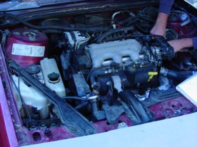

The engine is a 3.1l oldsmobile cutlass ciera The drawing shows alternator below exhaust manifold it is above in what I can see in other pictures I have seen Attached a pic while he was taking it apart!

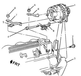

more like this?
https://images.2carpros.com/forum/automotive_pictures/261618_Noname_2150.jpg
May 12, 2010 at 7:55 AM
HGKNOWLES
Think I can figure out the 3.1 PS pump mounting But Alternator looks correct sure a lot of brackets holding brackets!
