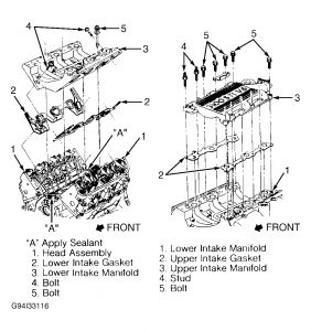

I need to find the bolt torque specifications for the lower intake manifold and the upper intake plenum for 1994 oldsmobile cutlass ciera.

tighten lower intake vertical bolts to 115 INCH lbs and diagonal bolts to 115 INCH lbs as well. the upper intake torques to 18 Ft. Lbs.
