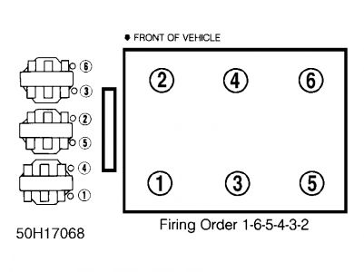

I had some kids switch the wires around can u tell me which plug wires go to which hook up on the distributor? ty..

https://images.2carpros.com/forum/automotive_pictures/108325_33_order_1.jpg

HELP I had someone rip all the spark plugs wires off my car. I guess this is some kind of fun joke. Well I went out and got a book and he showed me the firing order 123456 in a right hand motion with #1 wire at the 1 o'clock position. When I start the car it does start it isn't running correctly I pulled the spark plugs and 3 were fried off after just a few minutes. I put new plugs in and stared it again and I'm getting the same results Is his he correct firing order? thanks

The picture is for the 2.8v6 and the firing order is 123456, the 135 bank is the rear bank.
