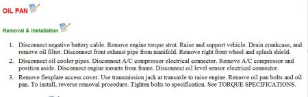

1993 Oldsmobile Ciera 6 cyl Two Wheel Drive Automatic
how do you change the oil pan and the cost of parts needed
Aug 3, 2010 at 3:30 AM
MHPAUTOS
  • 31,937 POSTS
Hi there, See text for sump removal information. A new sump will be about $130.00 Gasket $25.00 Labour is around 2 Hrs for a work shop to do, it will take you a bit longer at home as you don't have the advantage of a hoist.
https://images.2carpros.com/forum/automotive_pictures/61395_Capture_69.jpg
