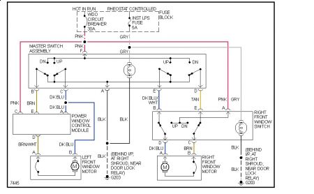

1991 Oldsmobile Ciera 6 cyl Front Wheel Drive Automatic
power windows won't work fuse ok checked at door switch for voltage ok no windows will work
help howard
Mar 25, 2010 at 8:19 AM
JDL
  • 16,098 POSTS
Hi, did you check power window circuit breaker for voltage? Also check ground at the master switch, sometimes you can use a redundant ground, just for testing. The wiring diagram below is for a two door.
