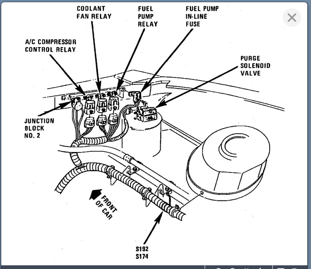

Where is the fuel pump relays located on the 2.8L?

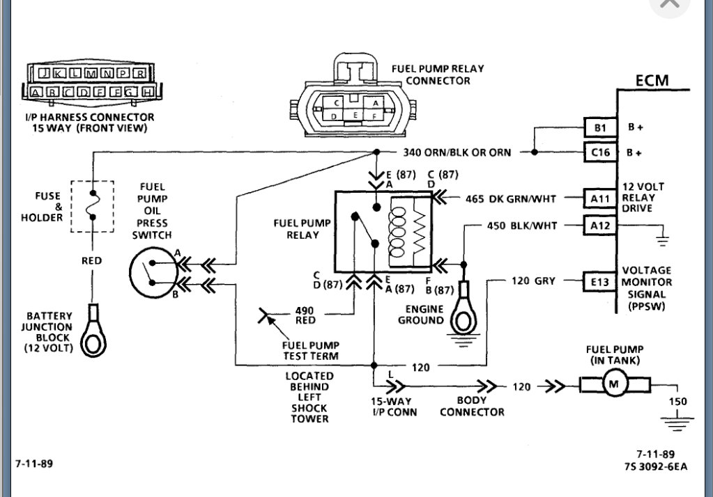

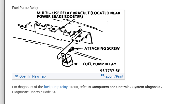

I am attaching the info below on this relay.
Please see this guide that will help with testing this relay as well:
Please see the info attached and let us know what other questions you have on this.
