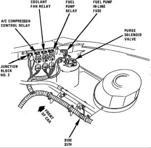

Engine Cooling problem
1988 Oldsmobile Ciera 6 cyl Two Wheel Drive Automatic
The fan does not come on. Where can I find the 1) temp sensor, 2) fan relay, 3) fan switch? Is there anything else I should be looking at? Thank you for your help ! !

Power the fan motor direct from the battery if okay test the sensor and relay
https://images.2carpros.com/forum/automotive_pictures/12900_cts_1.gif
https://images.2carpros.com/forum/automotive_pictures/12900_fr_6.jpg
