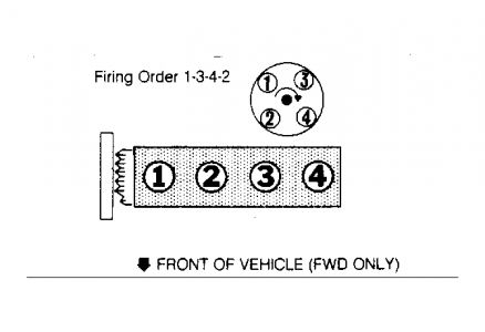

Need the location of wires from the spark plug to the distributer cap.

THis is for the 2.0L. If you have a 1.6L, let me know.
Let me know if this helps.
