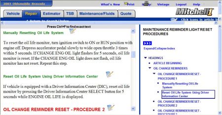

I just want to know, I changed the motor oil do you have to reset it so it could say 100% ? If so how is it reset?

Do below
https://images.2carpros.com/forum/automotive_pictures/12900_oil_l_1.jpg
