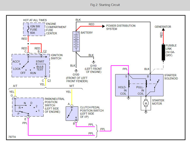

when i turn the key nothing happens,no movement or sounds. i have replaced the starter relay,neutral safety switch and ignition switch.the starter motor has been bench tested and is working.what do i try next?

This sounds like a ground problem. Have you checked all of the ground leads from the battery, body ground straps...? Also, Have you checked for power to the starter, relay...?
We are losing power somewhere here is a guide to help us find out where.
Here is a starter wiring diagram (Below) to help us see how the system works and check for power.
Let me know. If you are getting no power to any of the components, are you getting power to the accessories?

I have power to what appears to be all accessories.The only thing that doesn't is the remote locks which previously worked. There is power to the starter,but none to the solenoid when the key is turned to start.When I jump the solenoid the engine turns,but it won,t start.I have cleaned all grounds in the engine compartment. periodically the dash display says unknown driver but has no effect on any functions.Your help is greatly appreciated.

The security light turns off when the key is left in the on position.Is it possible that this is a PCM issue? I can bypass the starter relay and the key activates the starter, but engine still won't fire. According to the wiring diagram,the starter relay runs through the PCM. thanks again for all of your help
