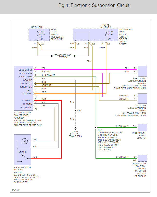

My Bravada has rear air suspension system. It has inflated and the rear will not go down. My "Haynes Manual" is absolutely worthless. I can't find any information to help. Please advise where and what I need to check or replace to get my rear out of the air.

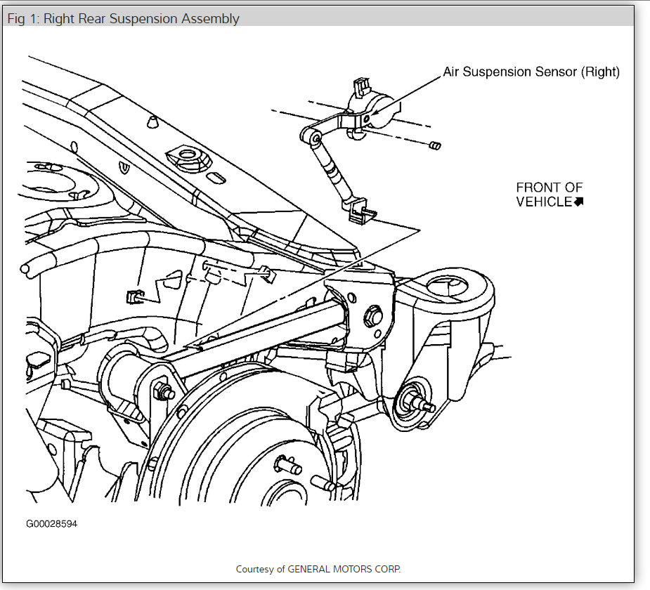

Is sounds like the level sensor is out here is a wiring diagram of the system so you can see how it works and the location of thee sensor so you can replace it.

Thank you for this post I had the same problem and got the sensor for $132.00 fix it right up. I love this site.
