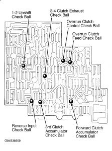

Just changed the sun shell in the transmission. The vehicle drives perfectly forward but will not move when shifted into reverse and you can not push it backwards in neutral. Initially the vss sensor and the propshaft sensor were switched around so I drove it for about a week with no speedometer. I took the oil pan, filter and transmission valve body off to inspect the check balls and then realized the sensor plugs on the transfer case were switched around. I put everything back together and switched the sensor plugs to their correct positions. The vehicle now works properly except for the above conditions. When I put the Bravada in reverse it sounds like it engages it just won't move. Any ideas?

Was running find before valve body was dropped I believe misplaced one of the balls in the valve body

I still believe its in the valve body since every thing was going OK before
when engine running gear selector in neutral or reverse valve body channel fluid pressure to move the truck
if the check ball is missing or misplaced you are going to run to that problem
also other possibilities
2-3 shift valve stuck
valve body spacer plate and gasket incorrect, mispositioned or damaged
