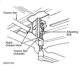

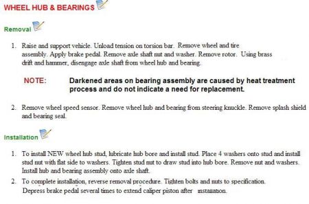

I am trying to replace the right front hub on this vehicle due to a bad wheel bearing. Do I need to use a hub and knuckle separator to accomplish this. All bolts are off but hub seems stuck on the threaded axle shaft i am a fair mechanic but very unfamilular with awd front ends ect. Thanks Jon Lewis
