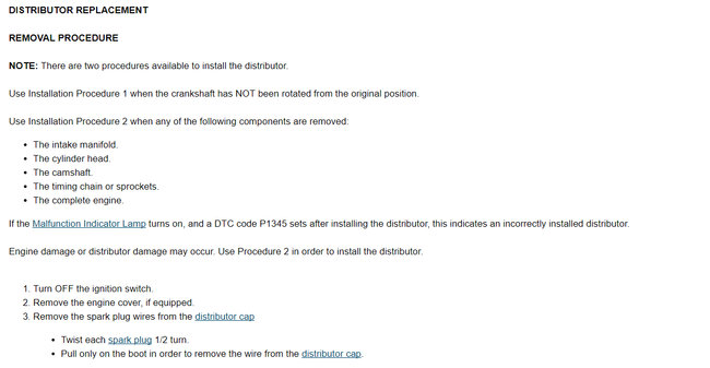

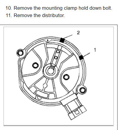

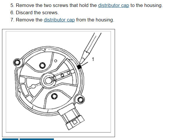

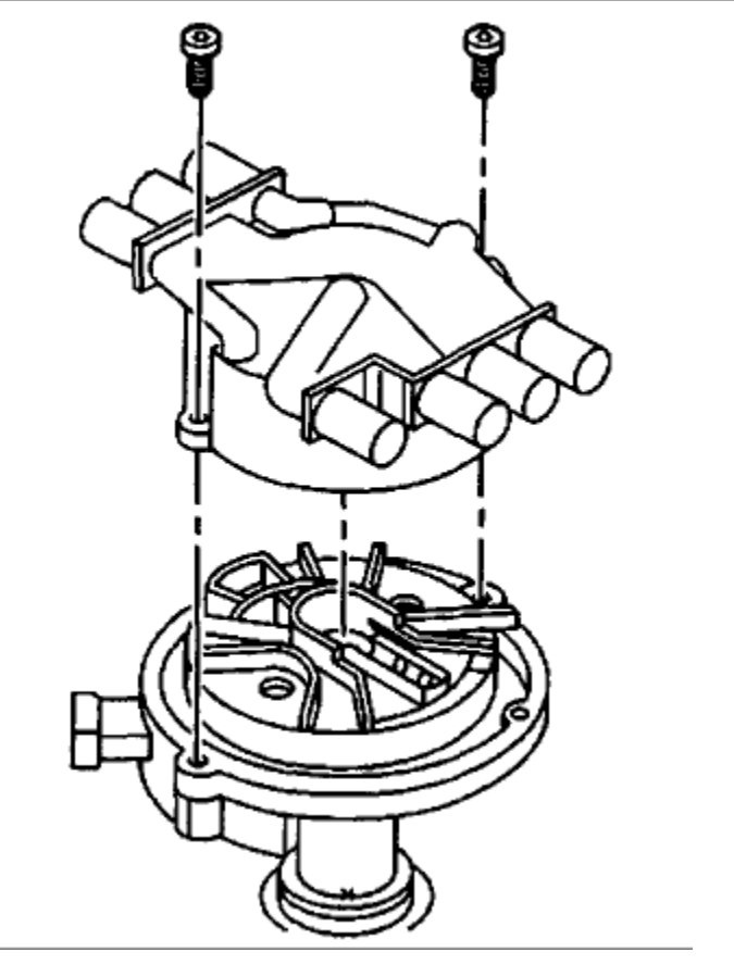

i replaced the intake manifold gasket put everything back but i think the distributor moved and i didnt mark anything to realign distributor. now the car cranks but will not start.do i need to turn the crankshaft.
Oct 21, 2008 at 3:16 PM
  • 54,837 POSTS

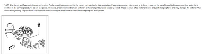

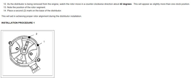

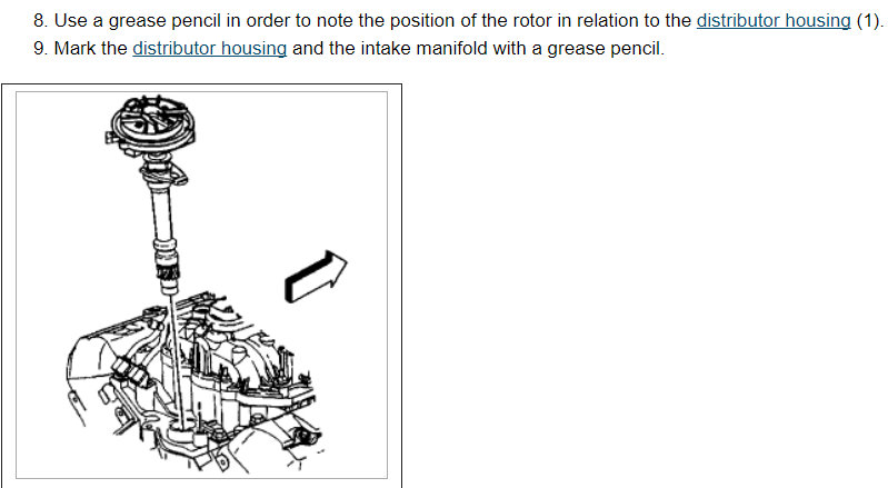

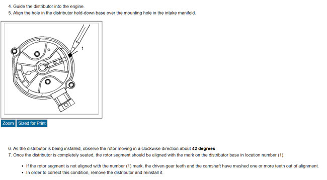

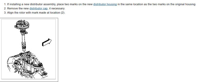

You will need to put the engine on TDC to begin. Here are the complete instructions for installing the ignition distributor for your car (below)
