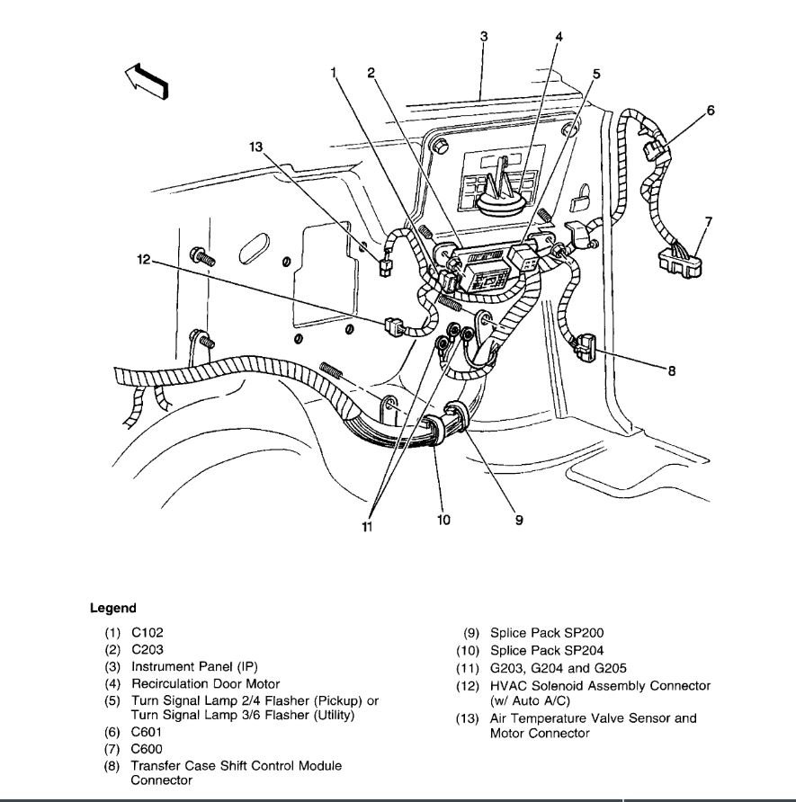

Where is the turn signal flasher located on this vehicle?
Tuesday, April 7th, 2009 AT 9:19 PM
23 Replies
BLUELIGHTNIN6
  • 16,542 POSTS
Front seating area, passenger side, behind dash, under access panel, mounted in fuse panel in glove compartment behind
Thanks for using 2CarPros. Com!
See diagram below for location of the flasher relay in your truck

Where is the turn signal flasher located on my 96 bravada
+2
Sunday, January 13th, 2019 AT 6:06 AM (Merged)
BLUELIGHTNIN6
  • 16,542 POSTS
Front seating area, driver side, driver side of steering column, behind instrument cluster, mounted in convenience center
