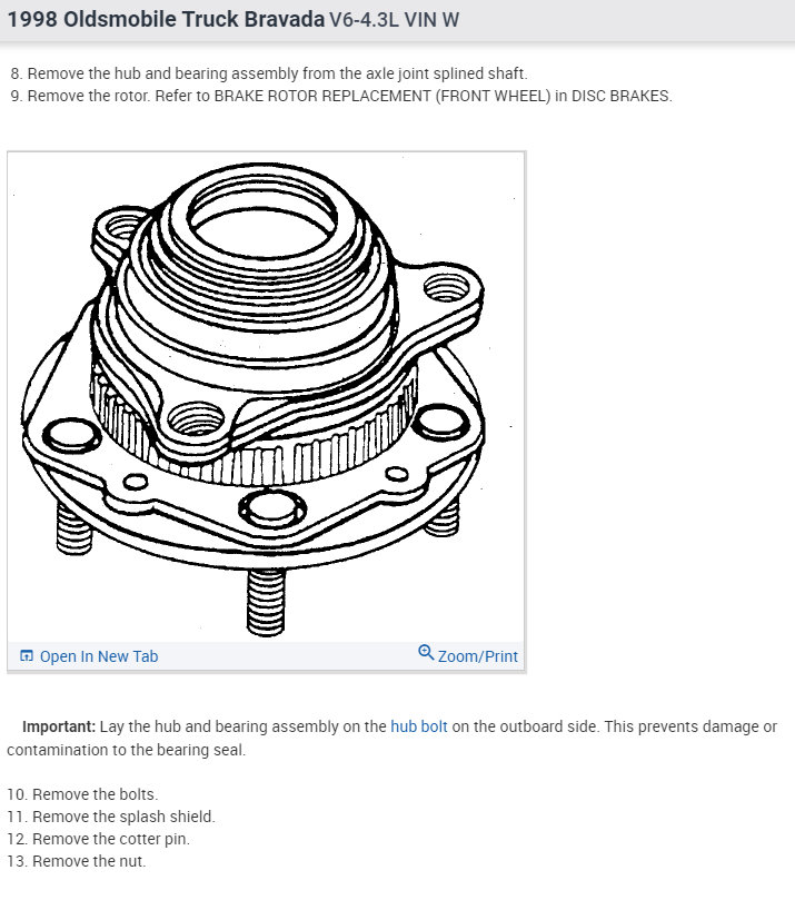

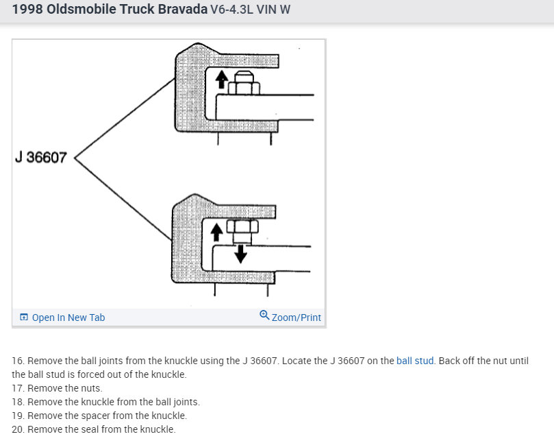

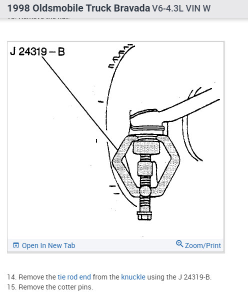

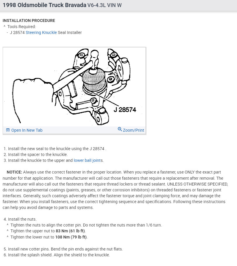

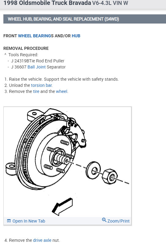

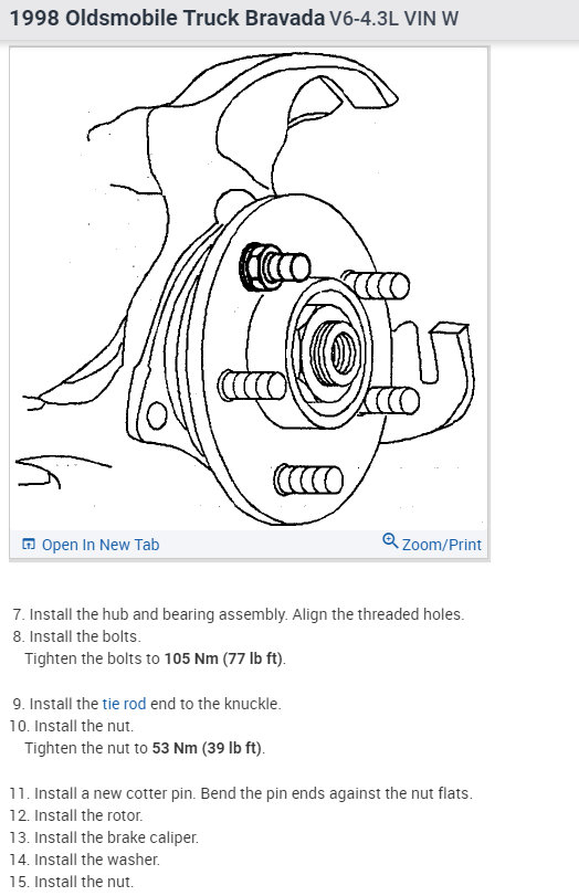

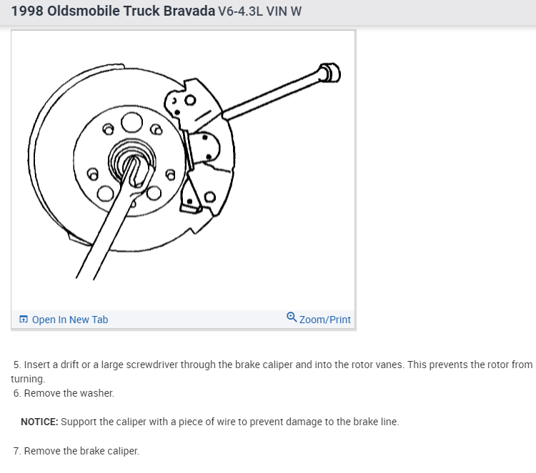

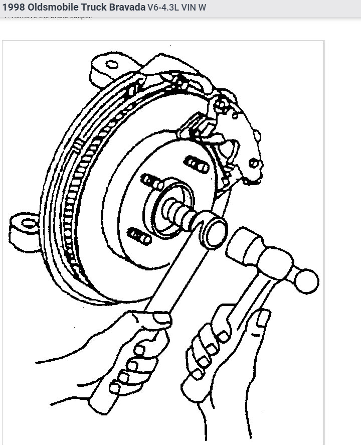

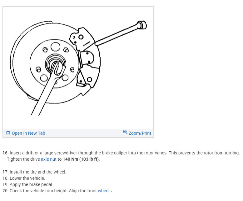

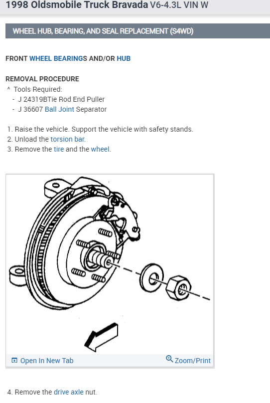

This vehicle is equipped with bearing hub assembly.
The bearing is built into the hub, and it gets replaced as a unit.
This can be done using basic hand tools.
Here is a helpful guide:
https://www.2carpros.com/articles/bearing-hub-replacement
I have attached the replacement procedure below for your reference.
