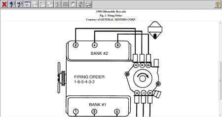

I can't get the engine back in timing. I removed the distributor to replace the intake manifold gaskets.
Jul 22, 2009 at 6:37 PM
  • 75,992 POSTS
Remove the distributor-Now put the engine no.1 piston on its compression stroke and line up the timing marks 0/TDC at the vibration damper. Now set the distributor in and make sure the rotor tip is pointing to no.1 cap tower and then follow the firing order.
