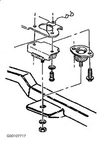

i have a 97 old that need the motor replaced but i cant seem to find a way to seperate the motor from the torq converter. is it even possible or am i over looking the bell housing cover? does the torq converter have to come out with the motor? i am absoulty puzzled never seen any thing like this please help!!!!

need to disconnect the torque converter bolts from the flywheel. then remove the transmission to engine bolts. remove front engine mount bolts and rear engine mount crossbar nut and washer. should be loose now.. transmission mount
https://images.2carpros.com/forum/automotive_pictures/261618_Graphic_268.jpg
