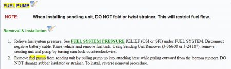

i just wanted to know if i have to drop the tank to take the fuel pump out or if i can get to it from inside the car

Tank needs to be dropped!
https://images.2carpros.com/forum/automotive_pictures/62217_Fuel_Pump_1.jpg
