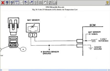

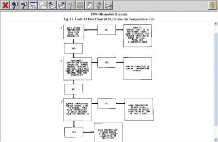

my bravada flashes the engine light sequence 2 slow and three fast what is it telling me is wrong. Plz help me.
Monday, August 11th, 2008 AT 8:47 PM
MECHANIC
75,992 POSTS
Code 23
Intake air temperature low
