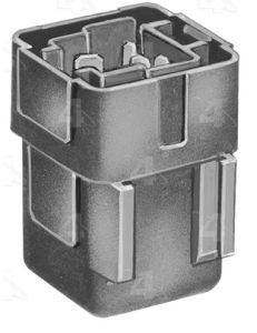

My ac compressor clutch won't engage on my 94 bravada. I think it is the relay but don't know where it is located. Can you tell me please.

A/C relay is located on bracket, on right side of firewall

There are 2 relays on the right side behind the brake booster. A large gray one and a smaller black one. Which of there are the ac relay?
Jun 30, 2010 at 9:47 AM
BLUELIGHTNIN6
  • 16,542 POSTS
should look similar to pic below

Is there anyway to bypass the relay to see if that's the promblem? Thank you.
Jun 30, 2010 at 9:55 AM
BLUELIGHTNIN6
  • 16,542 POSTS
would require some rewiring..easiest way is to simply swap the relay with another same sized relay on the vehicle.

Any idea which one to swap it with? The other relays I see are a lot bigger then the one in question. Should like a good idea I just don't know which one to swap it with.
Jun 30, 2010 at 10:03 AM
BLUELIGHTNIN6
  • 16,542 POSTS
no would just have to look for them , sorry.
you may also test the relay itself.. we have a great guide on how to test relays at https://www.2carpros.com/how_to/how_do_i_check_a_relay.htm
Jun 30, 2010 at 10:05 AM
CDADOVICH
  • 7 POSTS

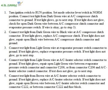

I changed the relay and the compressor clutch still won't engage. Any ideas what else it might be would be great. Thanks
Jun 30, 2010 at 4:47 PM
BLUELIGHTNIN6
  • 16,542 POSTS
follow the diagnostic steps below..
