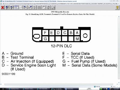

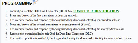

The Remote door lock will not activate the locks on the car. I have replaced the battery in the remote. The door locks work when manually activated inside the car. How do I fix it?
Feb 17, 2008 at 10:10 AM
MERLIN2021
  • 17,250 POSTS
Follow this programming guide...
https://images.2carpros.com/forum/automotive_pictures/62217_RKE2_1.jpg
https://images.2carpros.com/forum/automotive_pictures/62217_RKE1_1.jpg
