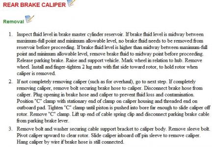

how do you remove the rear brake caliper? it looks like the top bolt is some kind of hydroic mechanism

https://images.2carpros.com/forum/automotive_pictures/261618_Noname_2289.jpg

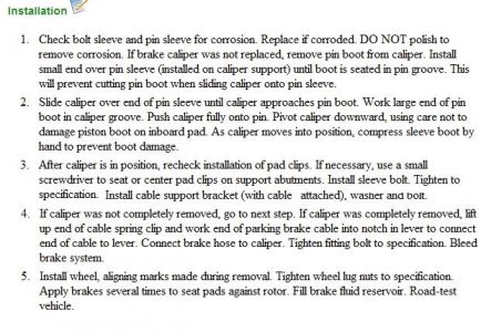

https://images.2carpros.com/forum/automotive_pictures/261618_Noname2_752.jpg
