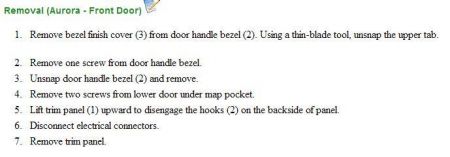

Interior problem
1999 Oldsmobile Aurora V8 Front Wheel Drive Automatic

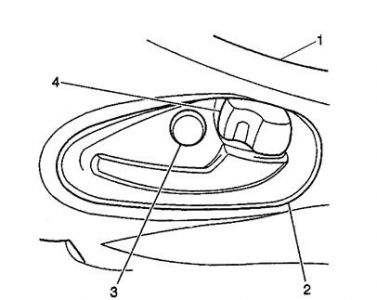

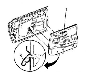

hOW TO REMOVE DRIVER SIDE INSIDE DOOR PANNEL
