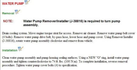

My husband, a reasonably good weekend mechanic, has spent three full days getting the old water pump off (no one let him know he would need a special part to accomplish this!) ... but we now have the old pump off ... Is there some trick to getting the new water pump installed? Something he is missing? Any info will be appreciated!

https://images.2carpros.com/forum/automotive_pictures/261618_Noname_801.jpg
