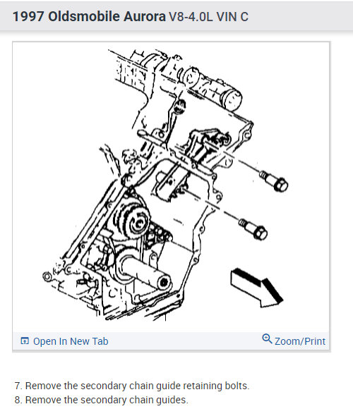

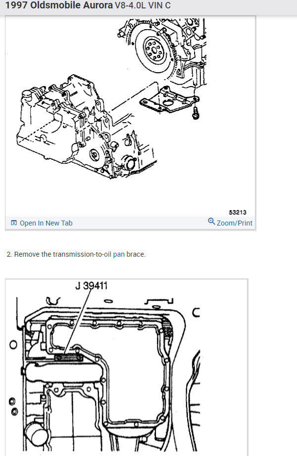

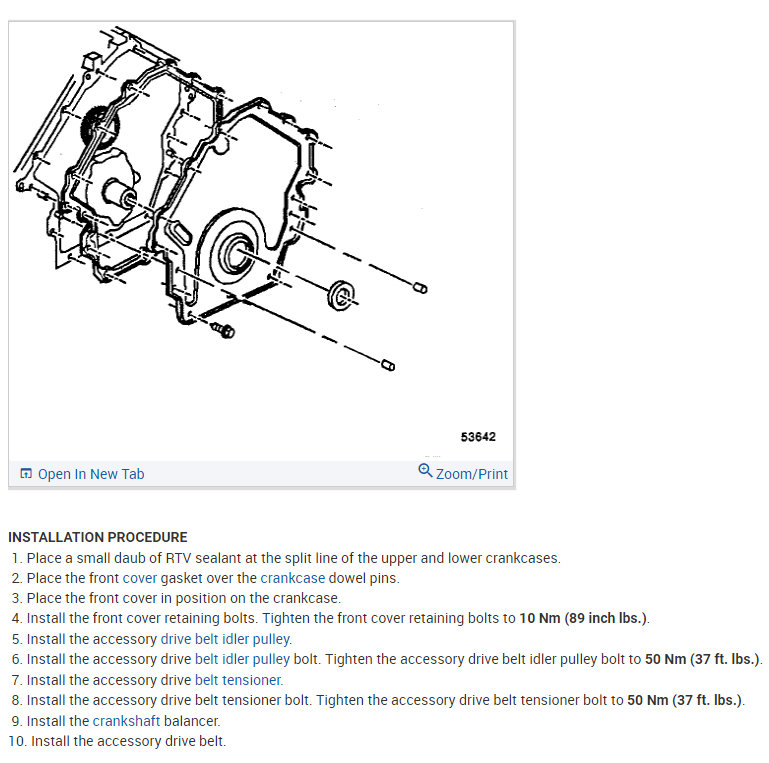

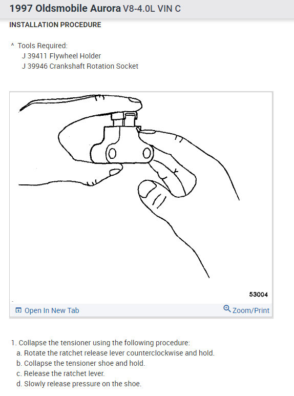

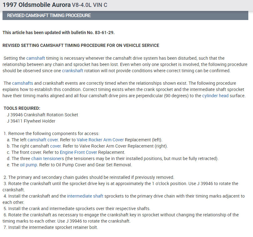

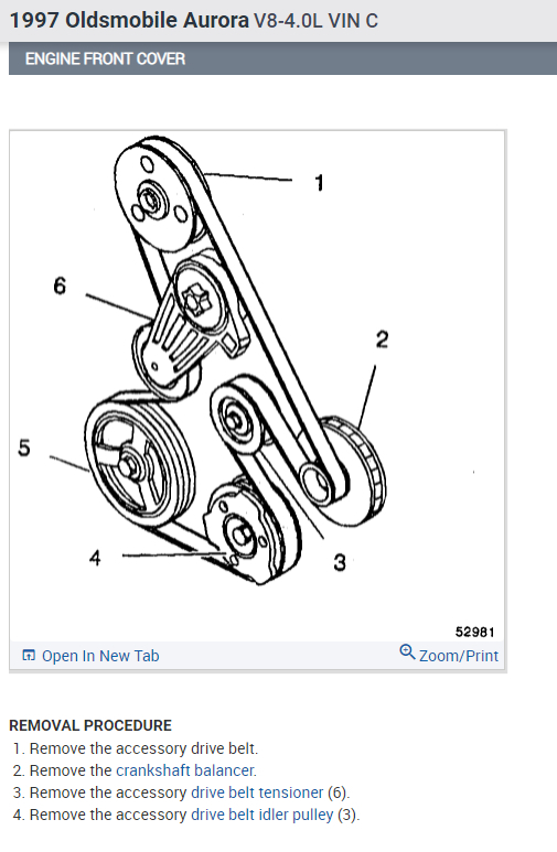

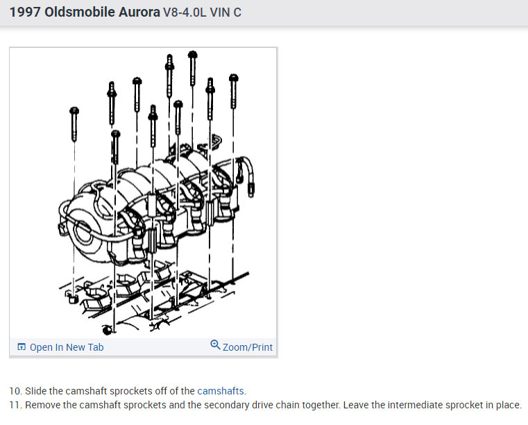

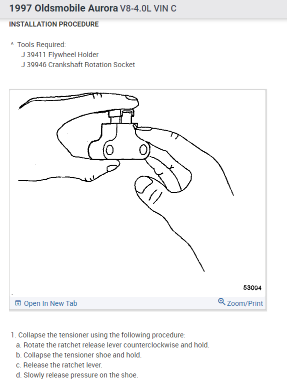

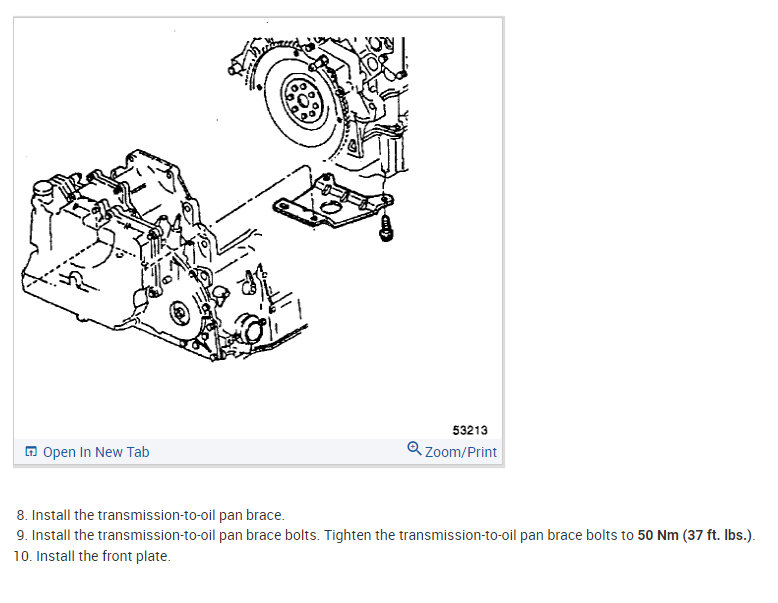

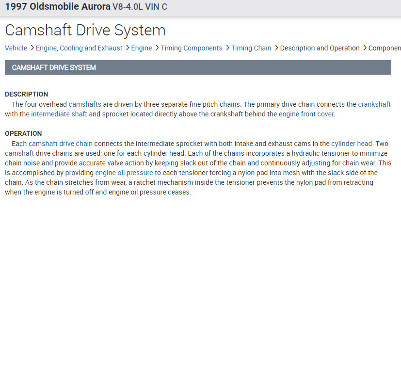

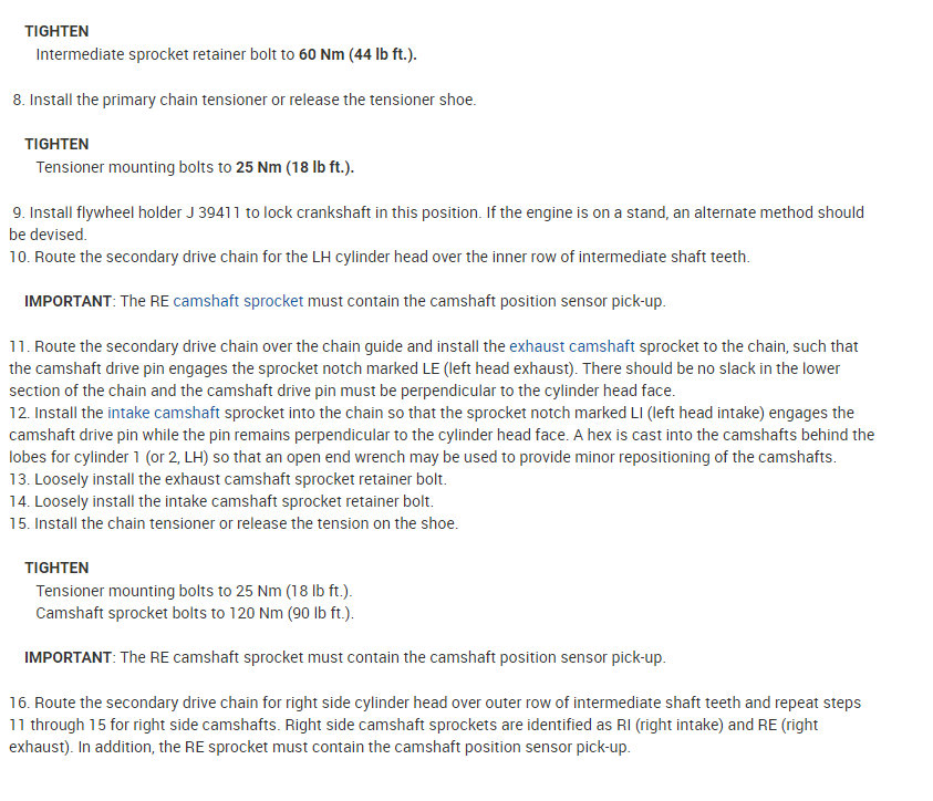

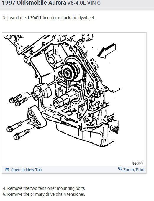

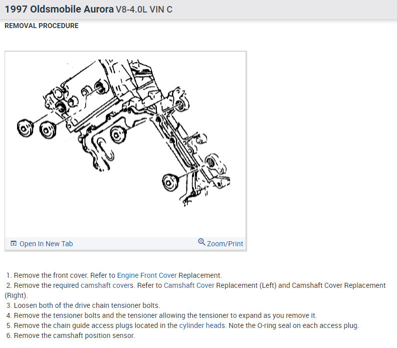

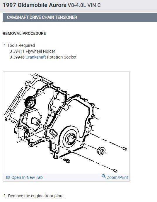

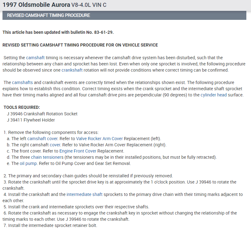

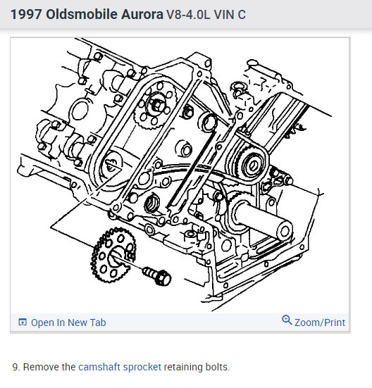

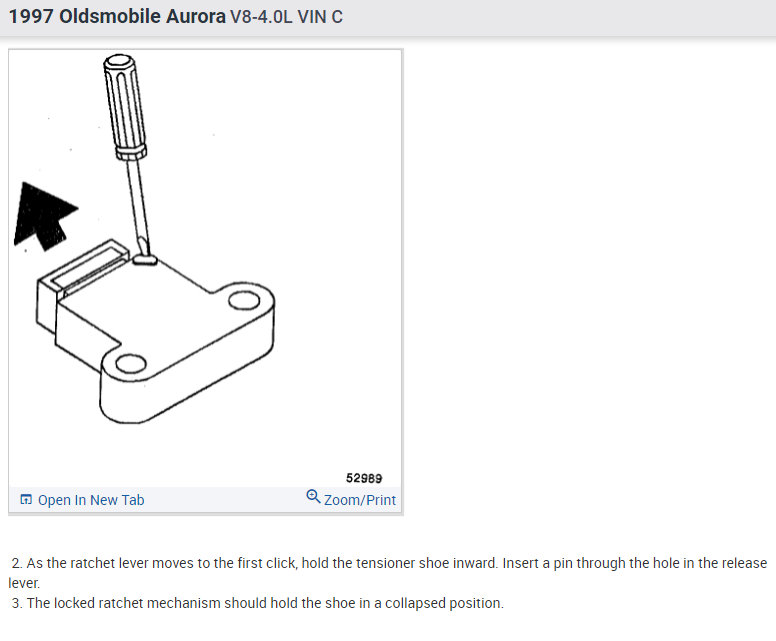

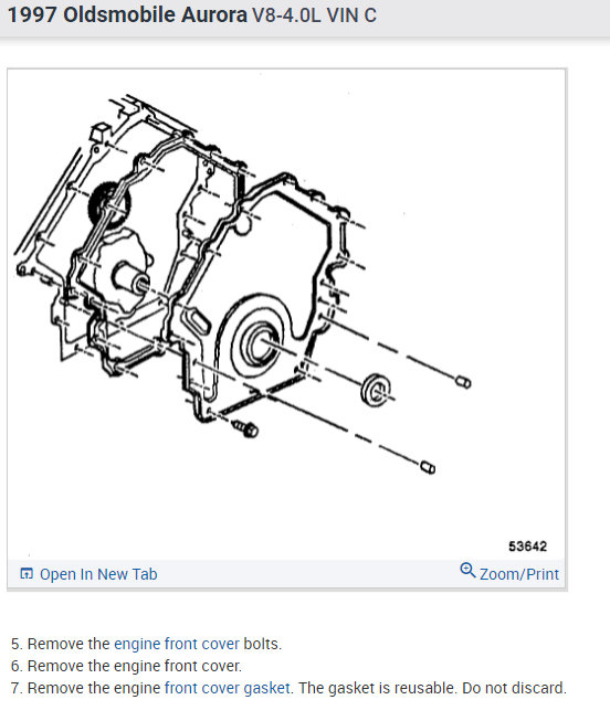

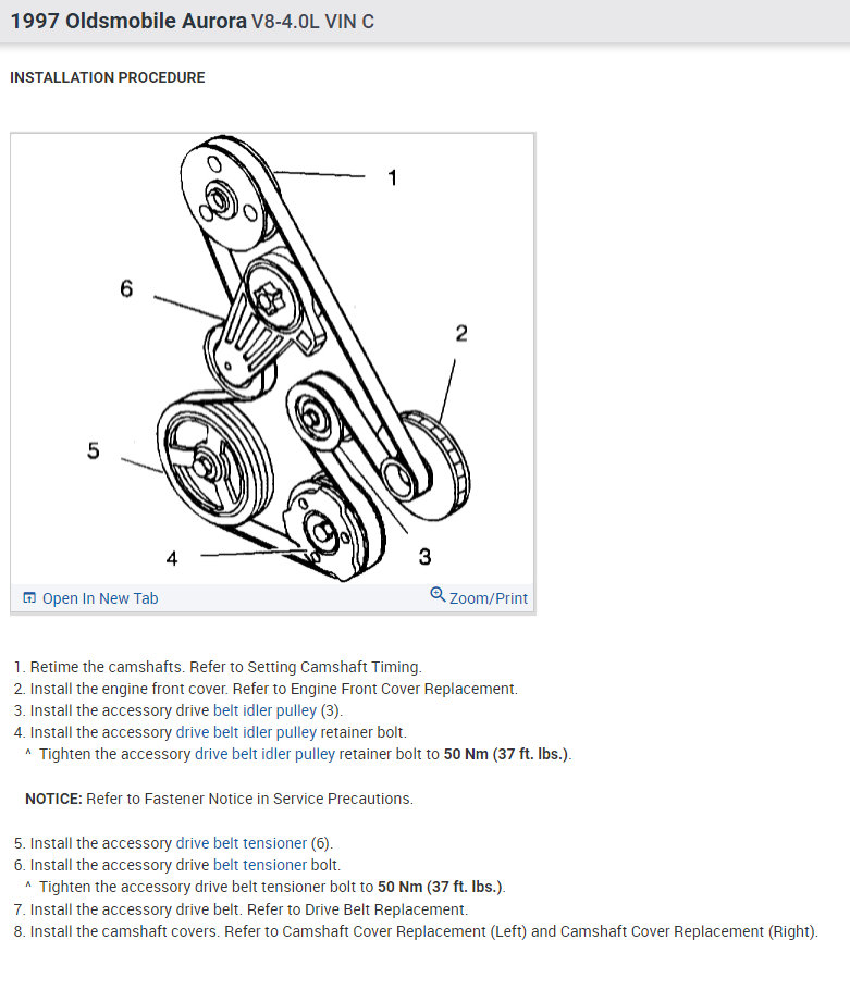

can you remove the timing chain cover with out pulling the motor
Nov 30, 2008 at 7:52 PM
SQM
  • 6,383 POSTS
It is possible to remove that cover without pulling the motor.
However it has very limited space.
You will have to remove the drive belt first, the you will be able to remove the cover.
