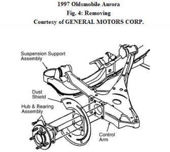

I believe that the hub is what it is called. But it is the part that the wheel bearings are in. But I was wondering how to take that off and replace it.

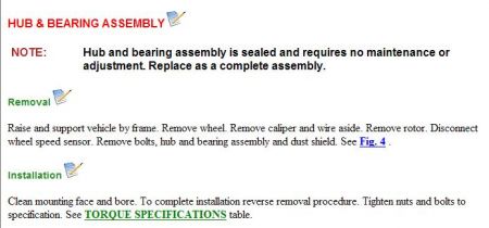

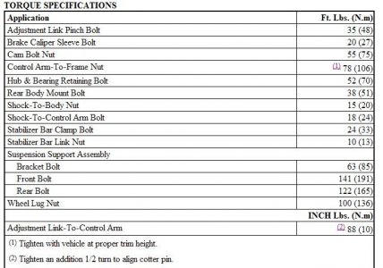

Hello Thanks for the donation Below are the replacement procedures for your vehicle's rear wheel hub & bearing assembly.
https://images.2carpros.com/forum/automotive_pictures/261618_Noname_387.jpg
https://images.2carpros.com/forum/automotive_pictures/261618_Noname2_107.jpg
https://images.2carpros.com/forum/automotive_pictures/261618_Noname3_50.jpg
