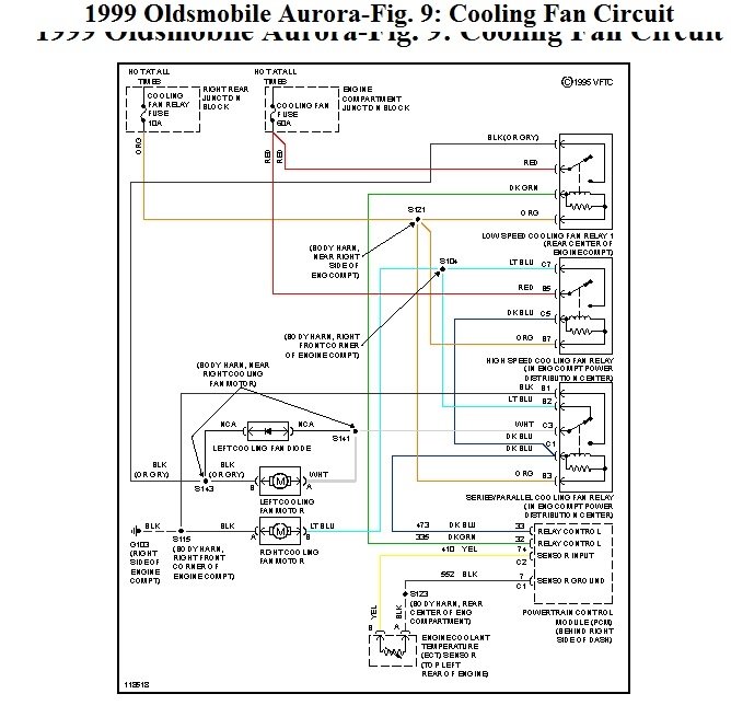

The engine cooling fans only start when the AC is on, the temperature gauge reaches normal temperature and beyond into the hot range.
It has reached 240, then I turn on the AC so fans turn on. Shouldn't fans turn on about 220? Is it a relay problem? Where is high speed relay located?
There are 2 fans. Both turn-on when AC is engaged. The temp gauge shows temp increase, so temp probe seems OKay. Where is temp sensor located? Where are cooling fans relays located?
Nov 1, 2010 at 1:35 PM
  • 54,840 POSTS
Hey Steetor,
I have gathered these guides for you to start checking things. This guide shows both the temperature sensor location and the fan relays. The BCM send the signal to the relays so if all else fails the BCM is bad but check the wiring diagrams first to be sure.
The fan relay locations are in the diagram. You might have to use an infrared non-contact thermometer to see if engine temp and gauge show about the same to make sure of the engine's temperature.

Since they come on, the relays can be assumed good. They default on with A/C to keep airflow across the condenser when stopped. The question is, what is the coolant temp sensor registering, and what indication of overheat are you getting. The fans should come on low speed at 229 deg(F), and high speed 234 deg. They are controlled by the PCM, so if the pcm is seeing this temp, the fans should be on. I would approach this by having the system scanned for PCM trouble codes. If there are none relevant I would try and read coolant temp sensor data with a scan tool, and at the least have the cooling system tested for combustion gas presence.

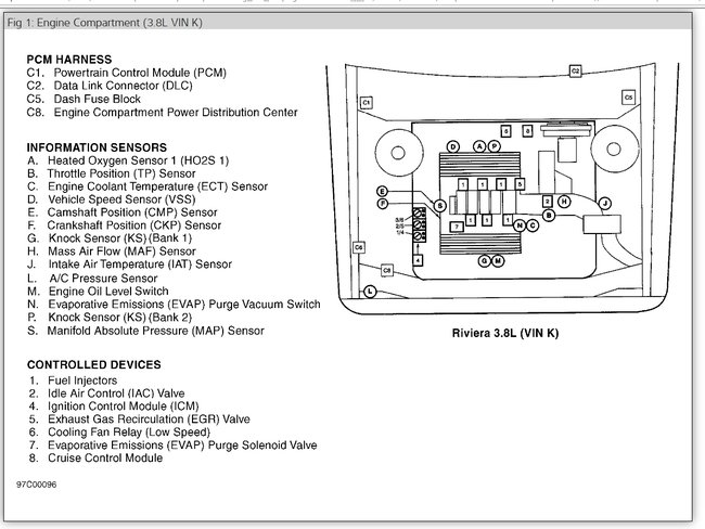

FANS ARE NOT OPERATING. MOTORS ARE GOOD. WHERE IS THE ENGINE COOLANT TEMP SENSOR? tHANKS
Oct 30, 2018 at 4:35 PM (Merged)
BLUELIGHTNIN6
  • 16,542 POSTS
For the 3.5L and 4.0L engines it is located at the rear of the right cylinder head. 4.0L engine's ECT sensor is pictured below..
https://images.2carpros.com/forum/automotive_pictures/261618_Noname_382.jpg
Also inspect cooling fan relays.. Thanks for using 2CarPros.com!

BLUELIGHTNIN6
  • 16,542 POSTS
your vehicle has 3 cooling fan relays. need to test them all. two are located in right front underhood relay center, the other is located at center rear of engine compartment.
