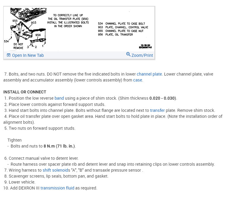

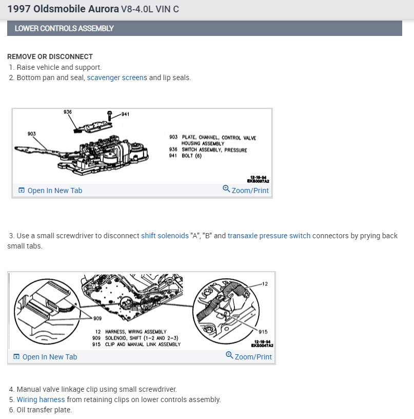

Since it is blowing the fuse immediately the issue is likely an electrical component.
Did the shop tell you what did they find? What was the faulty component?
Typically, when there is an issue with a solenoid the check engine light will get triggered.
Is your check engine light illuminated? If so, having it scanned can help with the diagnostics.
From the issue you have experienced it could be a faulty shift solenoid.
Here is a helpful guide on automatic transmission issues:
