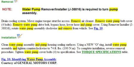

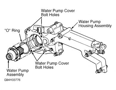

how to replace water pump
Nov 29, 2008 at 4:47 PM
MHPAUTOS
  • 31,937 POSTS
HI there, Water pump removal and re fit instructions. mark (mhpautos)
