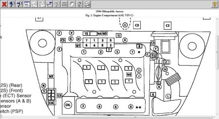

My speedometer bounces. Example: at 60 mph the speedometer will occasionally read 60, however, more often than not it bounces from 30-60, or pegs out at 0.

Hi hawkeye09, Welcome to 2carpros and TY for the donation Inspect and test the VSS (vehicle speed sensor) located at lower right rear of engine compartment on transaxle see below -location at G
https://images.2carpros.com/forum/automotive_pictures/12900_vss_21.jpg
