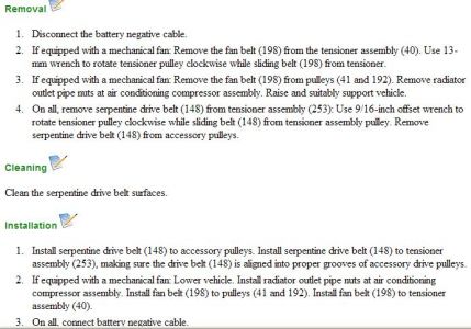

How to you change the water pump belt?
Aug 14, 2009 at 10:51 AM
BLUELIGHTNIN6
  • 16,542 POSTS
https://images.2carpros.com/forum/automotive_pictures/261618_Noname_816.jpg
Aug 14, 2009 at 11:55 AM
