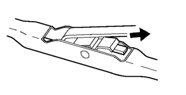

trying to change old wiper blades but cannot figure how they come off...need help
Jan 31, 2010 at 3:19 AM
  • 75,992 POSTS
WIPER ARM BLADE REPLACEMENT REMOVAL PROCEDURE
https://images.2carpros.com/forum/automotive_pictures/12900_wb1_1.gif
1.Turn the ignition switch to the ACCY position. 2.Set the wiper switch to the INT position. 3.Turn the ignition off when the wipers are in the midwipe position. 4.Push in the button of the wiper blade clip and remove the wiper blade from the inside radius of the wiper arm.

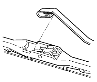

https://images.2carpros.com/forum/automotive_pictures/12900_wb2_1.gif
5.Bring the wiper arm out through the opening in the wiper blade. INSTALLATION PROCEDURE

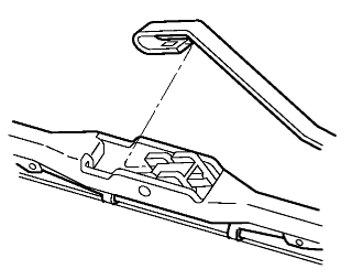

https://images.2carpros.com/forum/automotive_pictures/12900_wb3_1.gif
1.Insert the hook of the wiper arm through the opening in the wiper blade.

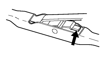

https://images.2carpros.com/forum/automotive_pictures/12900_wb4_1.gif
2.Position the wiper blade pivot in the inside radius of the wiper arm hook. 3.Pull the wiper blade pivot into the wiper arm hook until the pivot locks into the hook. 4.Operate the wipers and inspect for proper operation.
