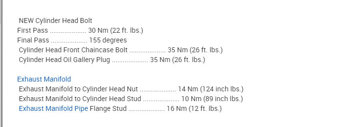

I need the torque specs for head bolts
2004 OLDSMOBILE ALERO
ROBERT TRIPP
i need the torque specs for head bolts
Apr 17, 2010 at 10:08 AM
I will attach the info requested but here is some other useful info that you may need for replacing and torque the heads.
https://www.2carpros.com/articles/how-a-cylinder-head-works

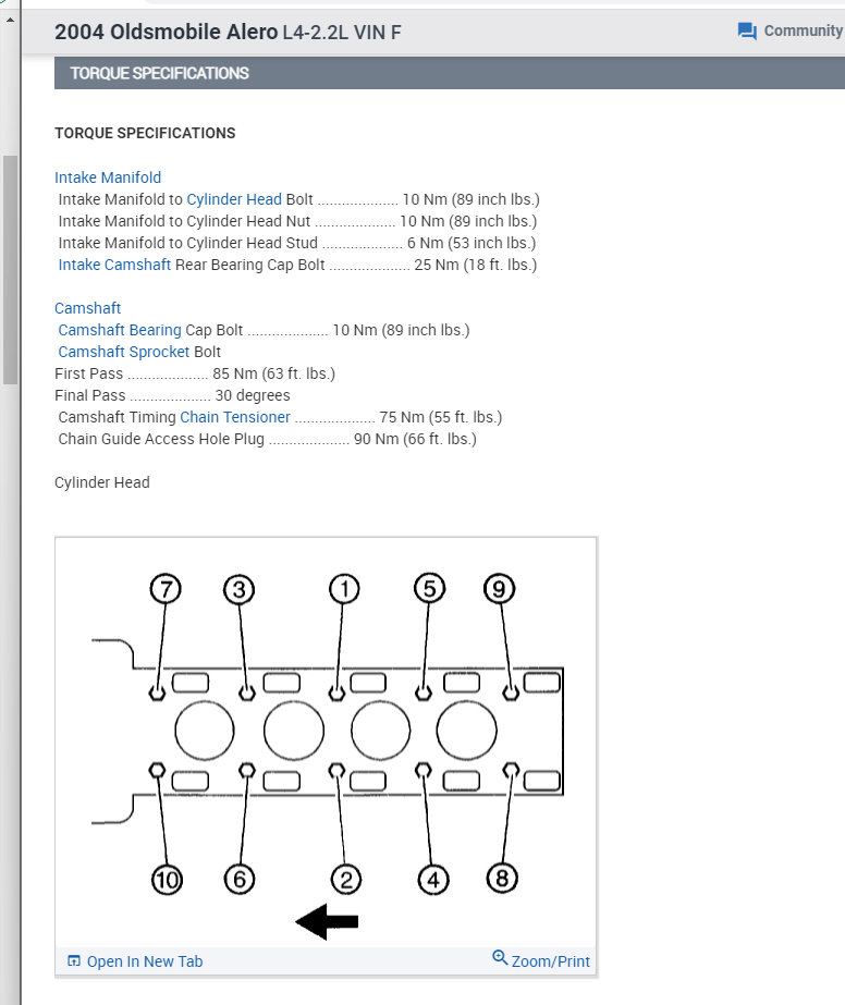

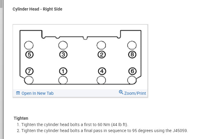

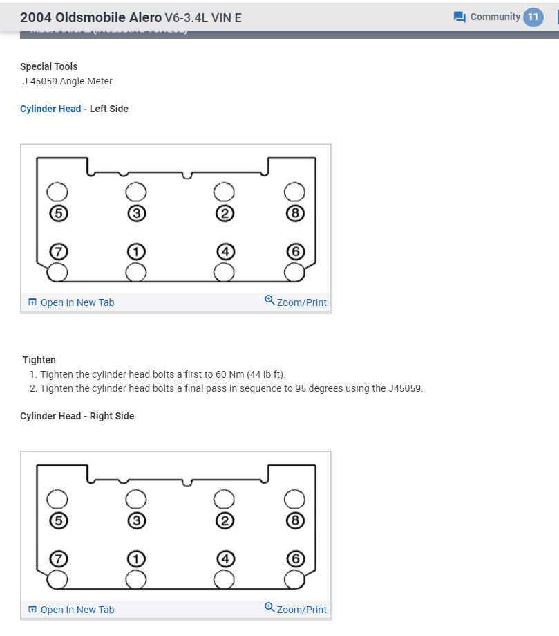

Also, you did not note which engine you have so I am attaching the torque specs and the sequence for each engine (4 and 6 cylinder). Please note the heading on the 1st and 3rd pages below.
Please let us know what other info you need. Thanks
