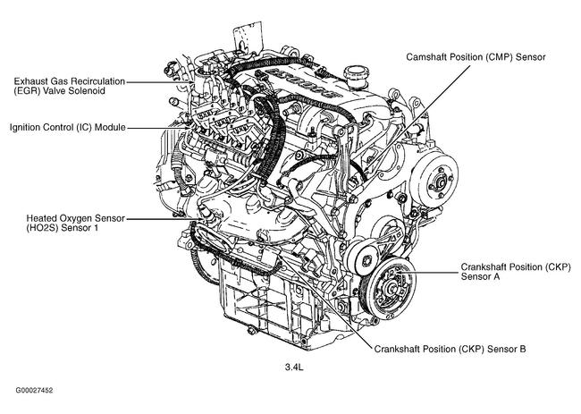

were is the upstream oxygen sensor located on a 2001 alero 3.4L

It comes before the catalytic converter. On V-6 engines, '96 and newer, there may be two of them, one for each side of the engine, and in that case they could be screwed into the exhaust manifolds. When there's only one upstream sensor, it is often screwed into the exhaust pipe right in front of the catalytic converter.

MISTY14
Can you send a picture of were the upstream oxygen sensor is.

CARADIODOC
  • 34,321 POSTS
This is from Mitchell On Demand. It's the only diagram I can find with an oxygen sensor, but there is likely another sensor on the front manifold. You can get the same information by clicking on the "Repair and Service" tab on the top of this page, then on "Manuals".

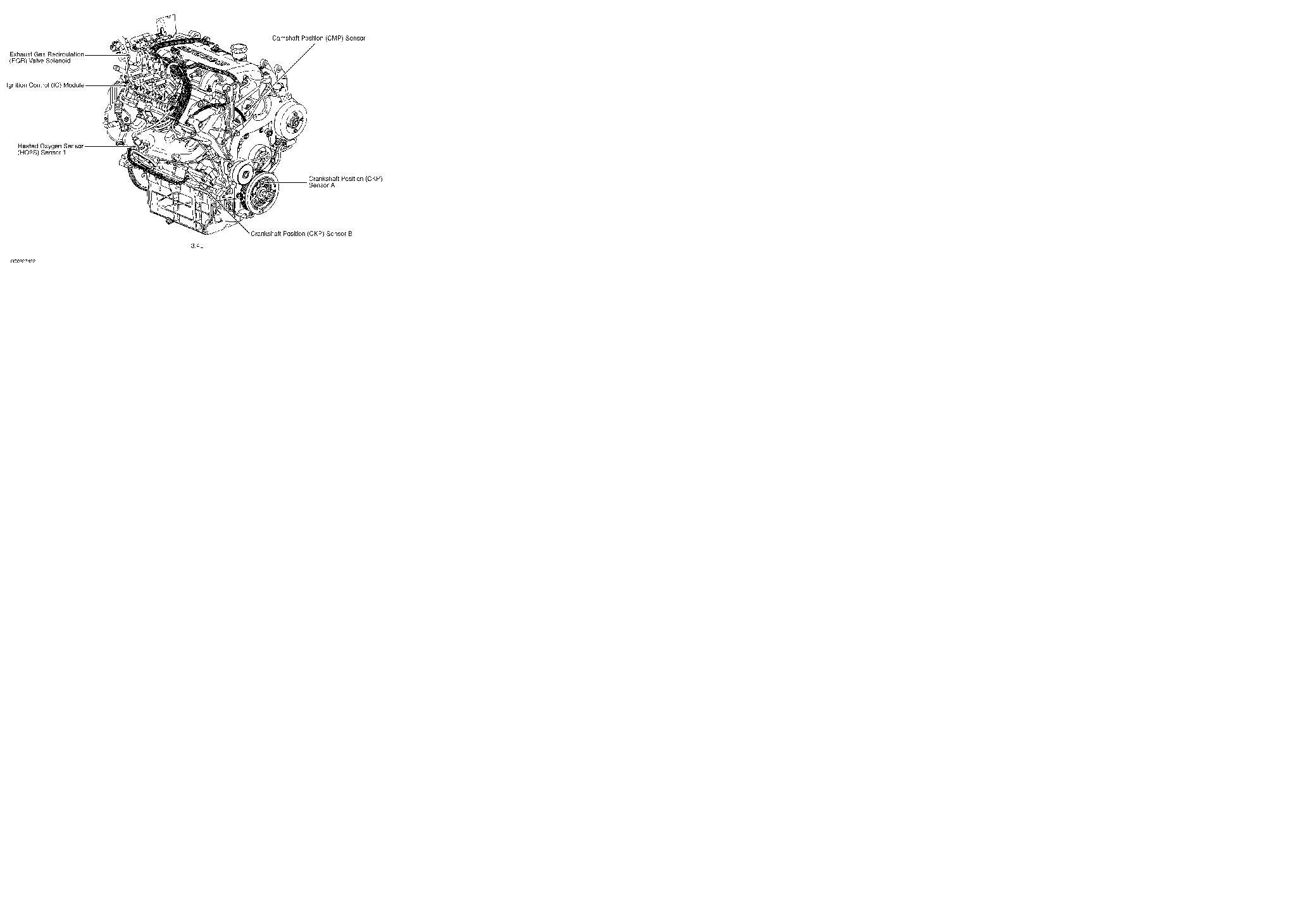

CARADIODOC
  • 34,321 POSTS
Try this.
