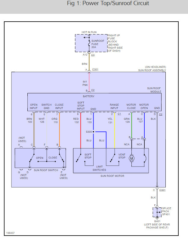

My sunroof is stuck in the vent open position and will not close. The sunroof continues to open and close regularly, but the vent stays open. I assume this is an electrical problem and replaced the fuse for the sunroof, but it did nothing. Can you let me know if you have seen this before and what i can do to fix it.

There is a problem with the limit switch for the sun roof unfortunately there is no easy fix with out testing the switches to see which one is not working. Here is guide to help you do the testing,
Here is the wiring diagram for the sun roof to help us see whats going on. Can you take a quick video of what the roof is doing and upload it here to the site so I can confirm the issue?

Ok so I've had some people look at it and there are brackets broken
Jan 19, 2018 at 7:36 AM
  • 55,423 POSTS
Can you upload pictures of the damage so we can tell you what it will take to fix it ?
