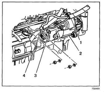

What is the procedure for replacing the starter? what has to be done first, second and third, ext. I am stuck.

REMOVAL PROCEDURE
https://images.2carpros.com/forum/automotive_pictures/12900_s1_23.jpg
Disconnect the negative battery cable. Raise and support the vehicle. Disconnect the electrical connectors (3, 4) from the starter.

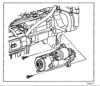

https://images.2carpros.com/forum/automotive_pictures/12900_s2_22.jpg
Remove the starter bolts. Remove the starter. INSTALLATION PROCEDURE

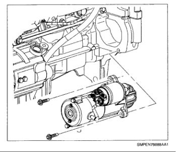

https://images.2carpros.com/forum/automotive_pictures/12900_s3_4.jpg
Install the starter. NOTE: Refer to Fastener Notice in Service Precautions. Install the starter bolts. Tighten Tighten the starter bolts to 40 N.m (30 lb ft) .

is there anything other than what you have mentioned that i need to remove it? Do i need to come in from the wheel well to get to these bolts? i have the top bolt half way out , but the ratchet does not have room to extract the bolt all the way. Do i need to take off the exhaust manifold ext.? i am still stuck
Dec 28, 2009 at 12:52 AM
  • 55,616 POSTS
You can get to these bolts using a 3/8 drive long extension and go in from the front of the engine at starter level use a universal 14 mm that should work. Send pictures of what you are up against if it doesn't.
