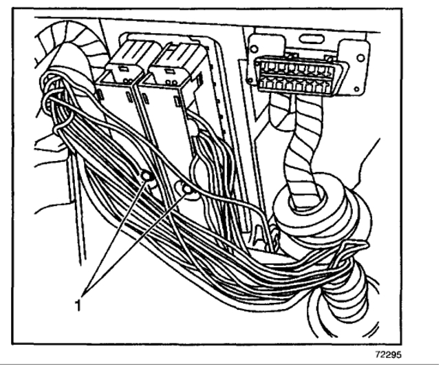

what does it take to replace the main computer. i have the haynes repair manual on this alero and i cannot find where the computer is located and how i should go to get to it. what are your suggestions.?
Feb 10, 2009 at 1:51 AM
  • 54,897 POSTS

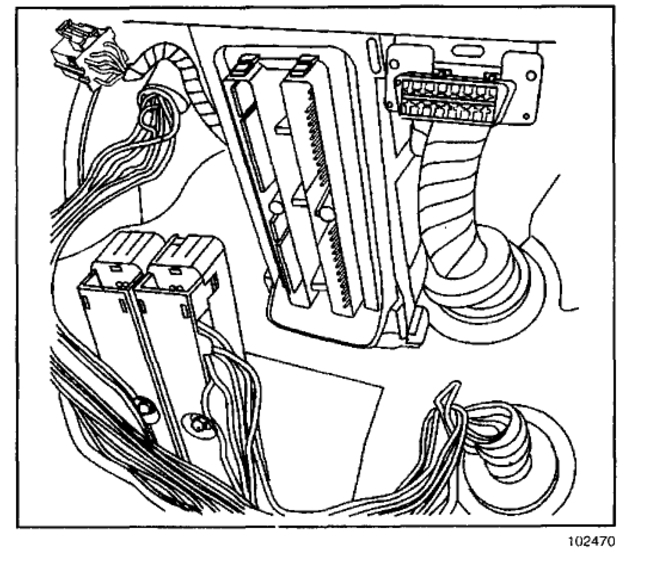

Here is the location of the ECM which is under the dash on the drivers side also the instuctions for reprogramming the unit.
