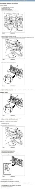

Sirs;
I need to replace the front left window regulator (electric windows) on a foru door Alero. How do I go about doing this?
Any help you can render would be great. Pictures if you have them would probably help.

https://www.2carpros.com/images/question_images/199426/original.jpg
