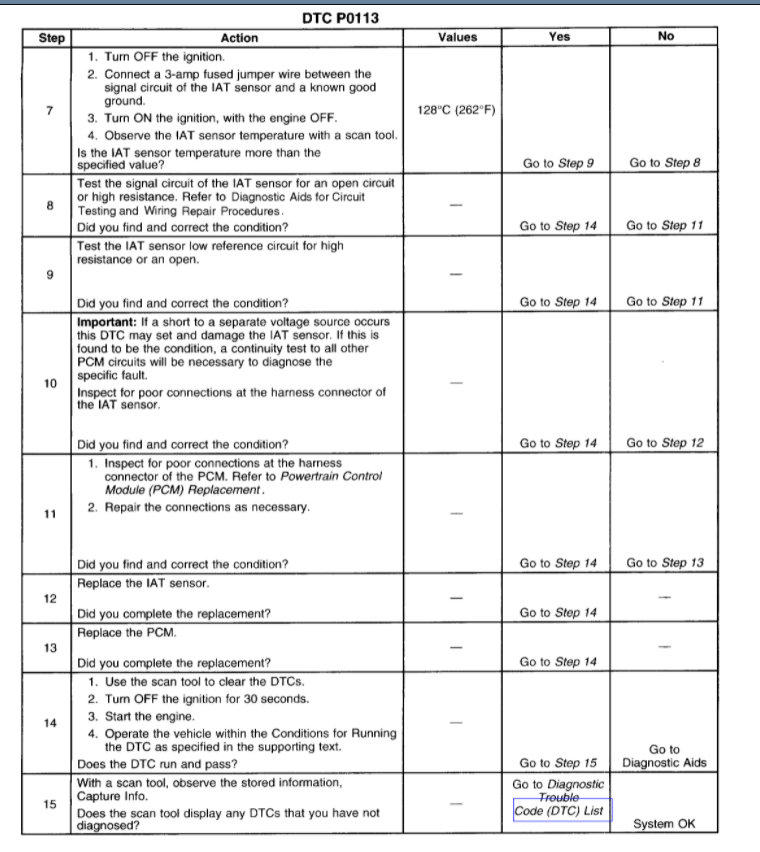

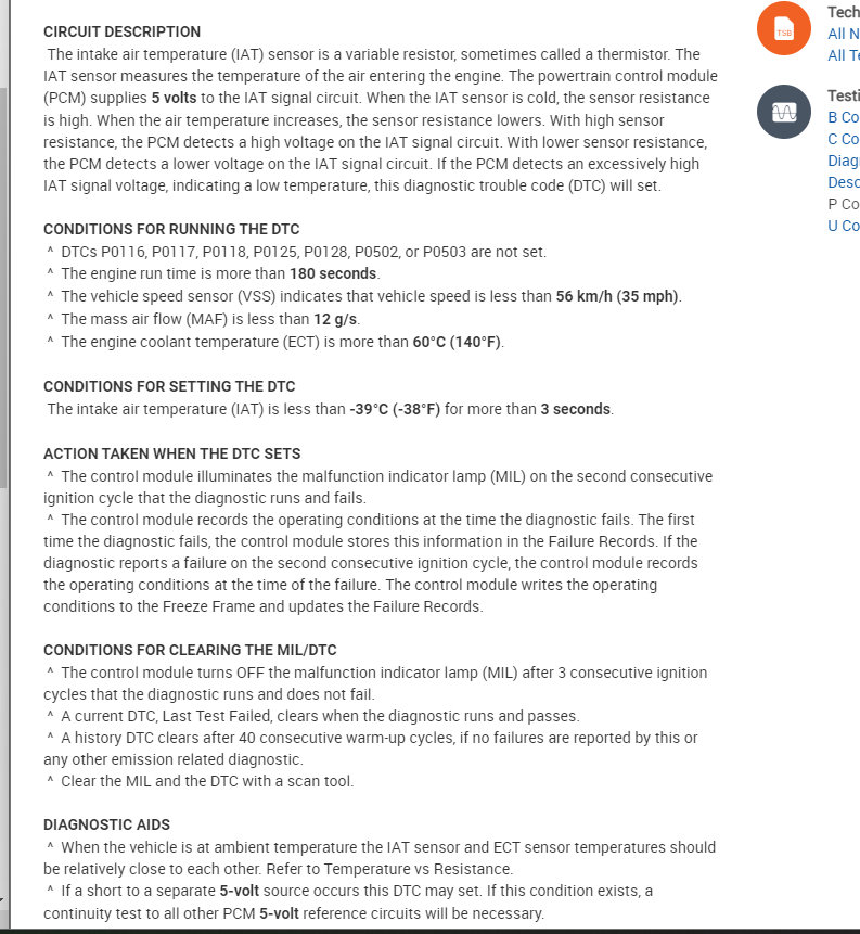

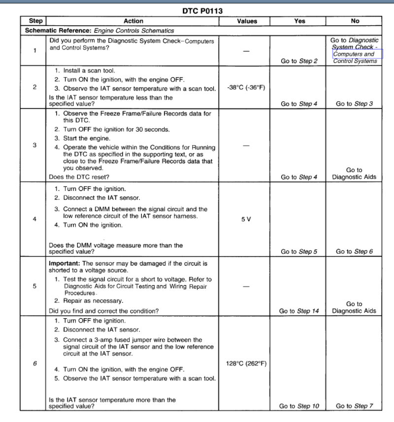

This code is in fact for the Intake air temperature sensor, however there are a couple things that can cause this. So clearly the sensor was not the issue.
So, let's check this code and find out what turns up. Here are a couple of guides that will help with this:
Below you will find the testing from the manual that will help with this. Let me know what questions you have with this and what you find when you run through the testing.
Thanks
