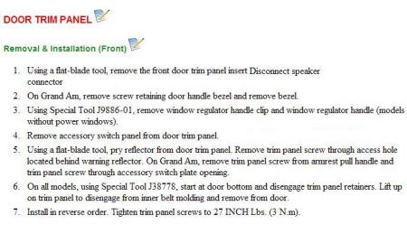

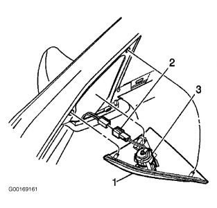

drivers side door window came off the track. how do you remove the door panel.

https://images.2carpros.com/forum/automotive_pictures/261618_Noname_1746.jpg
https://images.2carpros.com/forum/automotive_pictures/261618_Graphic_354.jpg
