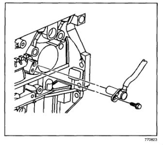

HOW DO YOU PUT ON A CRANK SENSOR FOR 2002 OLD ALERO 4CYL 2.2

REMOVAL PROCEDURE
https://images.2carpros.com/forum/automotive_pictures/12900_cranksensor1_1.jpg
1.Remove the starter. 2.Disconnect the crankshaft position (CKP) sensor harness connector. 3.Remove the CKP sensor bolt. 4.Remove the CKP sensor. INSTALLATION PROCEDURE
https://images.2carpros.com/forum/automotive_pictures/12900_cranksensor2_1.jpg
1.Inspect the CKP sensor O-ring and lubricate with a mineral based grease. 2.Gently insert the CKP sensor into the block.
