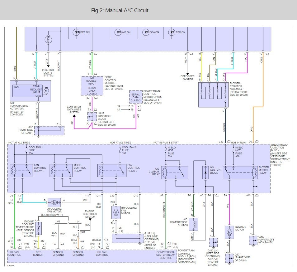

My car starting over heating so I checked under the hood and notice I had lost antifreeze from the surge tank. I added more antifreeze, started the engine and noticed the cooling fans were not running. Do they turn on only when needed or is there a problem with a fuse or relay? Thanks for the help!!

They turn on at a predetermined temperature. Do they turn on if you allow the temp to start going beyond normal?

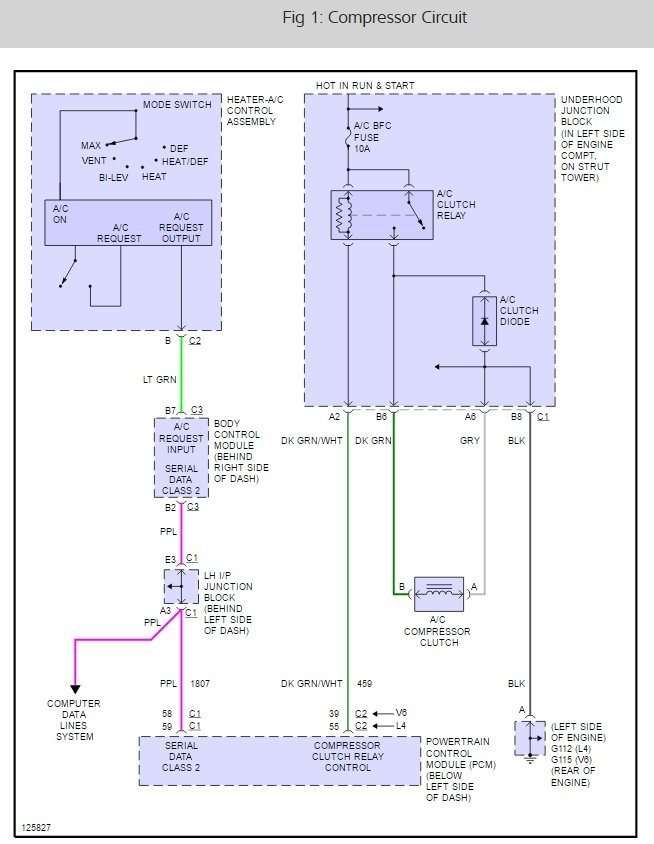

hi my aleros cooling fans will not come on the car overheats at idle but is fine on the highway i checked all relays and fuses jumper wired fans and both worked when wired straight to battery any ideas about whats going on also i wondered could the fact that the ac is not working have any thing to do with it could it be possible that the pcm reads no pressure and does not turn on compressor fan because fan should come on when ac button is on right?

it's possible, check for faulty A/C pressure switch, also test out the engine coolant temp. sensor.

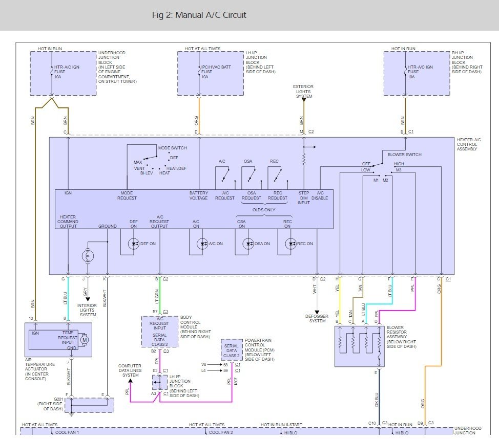

Cooling fans don't come on with AC, and now realize AC clutch doesn't engage when push the AC button

It sounds like the system has lost power so I would start by seeing if the fuses have power on both sides and then I would check the air conditioner relays. Here are some guides and air conditioner wiring diagrams to help you do some testing and get the problem fixed.
and
and
Please run some tests and get back to us so we can continue helping you.

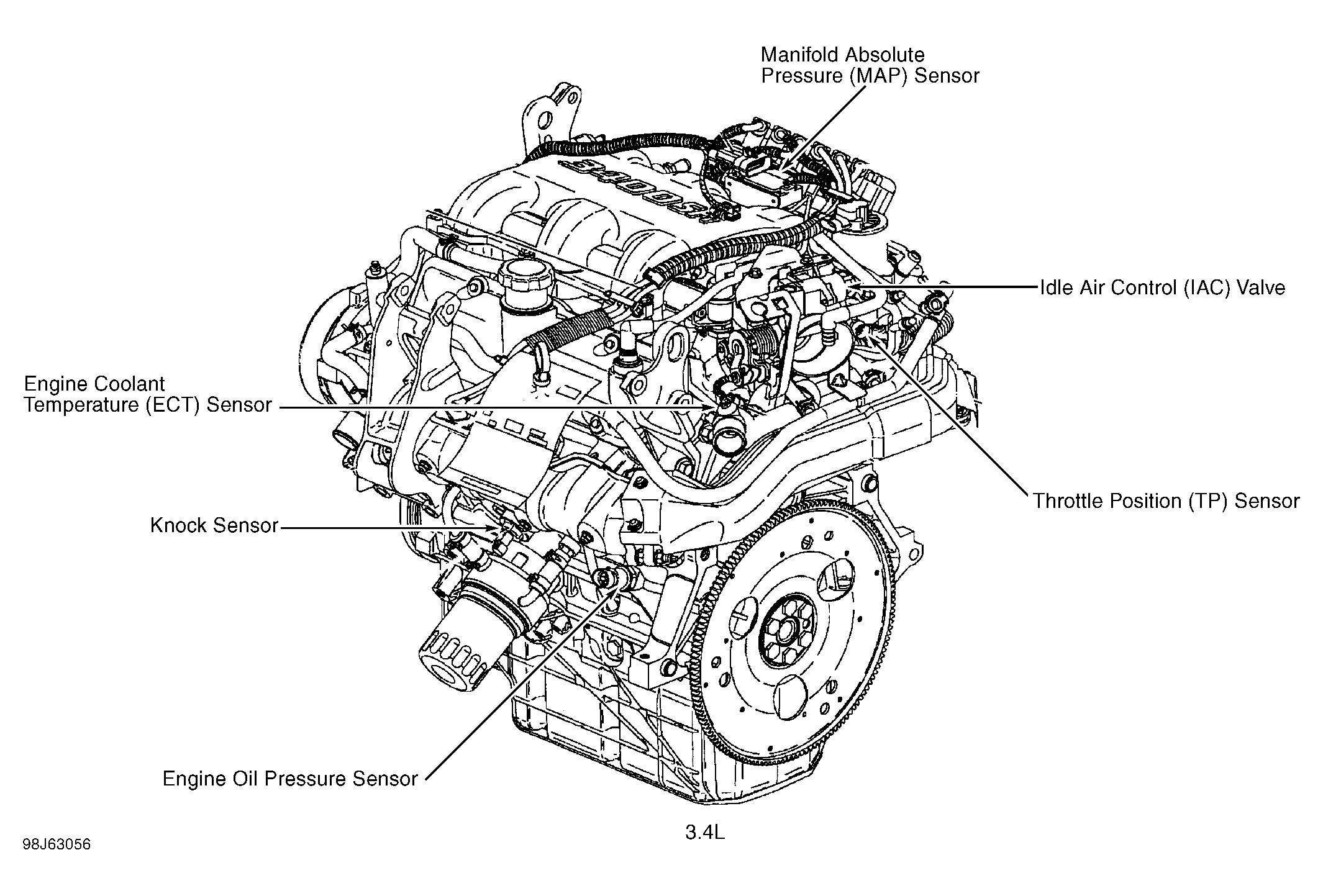

As the temp goes up,the fans should start and cool the rad,but not starting. I changed the relays around to see if this was it. I also checked the fuses,not it. I was told that it may be a thermostat sensor but do not know where it is located.

The coolant temp sensor is screwed into right where the upper hose goes onto the engine.Do you have a multimeter to do some testing?So the temp gauge goes up to where the fan normally comes on and the fan isn't coming on?Do any of the fans come on when the a/c is on at anytime?

The best way to solve this mystery is to get a infared temp gun that measures surface temps they are pretty cheap and can be used for a lot of different things.Use it to measure temp where the upper hose goes on the engine and see what temp its getting up too and when it reaches the correct temp about 225-226 you can see if the fan comes on if it doesnt then you can see if you have power and ground to your radiator fan motor and go from there.

Just replace intake manifold gaskets Upper & lower. No leaks engine runs fine. Fans comeon with A/C., & can turn them on with my scanner two speeds low & high. With car idling without A/C on. fan don't come on. Could the engine computer be the problem?
May 30, 2019 at 1:30 PM (Merged)
  • 75,992 POSTS
Check and test the coolant temperature sensor
KEWANTTOKNOW
I replace the coolant temp sensor, sensor below thermostat housing. Is that the sensor your replying to?
  • 75,992 POSTS
For what liter engine?
KEWANTTOKNOW
3.4L V6
  • 75,992 POSTS
See below
KEWANTTOKNOW
Yes I replace the coolant temp sensor. I check the voltage at the connector 5 volts on one and complete ground on the other one.
  • 75,992 POSTS
Could be the computer or a relay, have it further checked and tested
