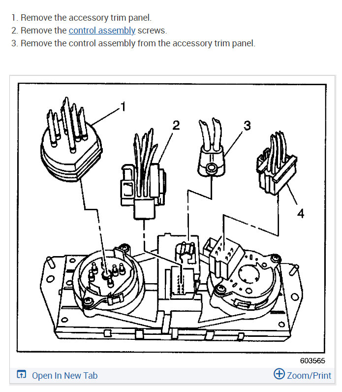

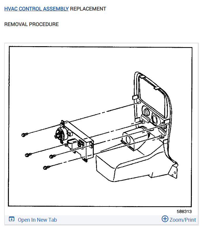

Switch only works on high fan speed. This switch was replaced during the first year. I need to know how to get the switch out so I may replace it.
Feb 16, 2009 at 9:49 AM
MASTERTECHTIM
  • 4,750 POSTS

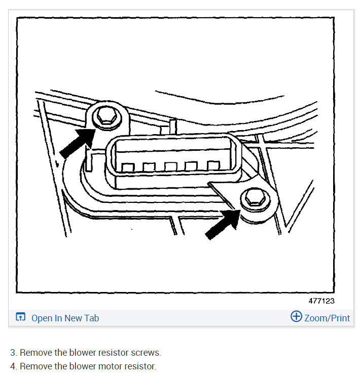

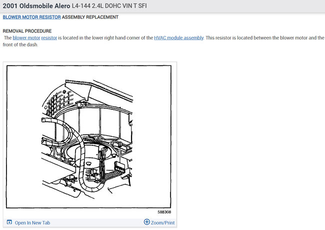

your problem sounds like it is the blower motor resistor, its located right beside the blower motor and its held in by 3 5.5mm screws. the circuit board on it will be burnt out, its very common and i think the new ones are updated so they don't keep burning out. i replace these at least on a weekly basis. Here is how to change the switch out and the resistor to help fix the problem. Check out the images (below). Please let us know what happens.
