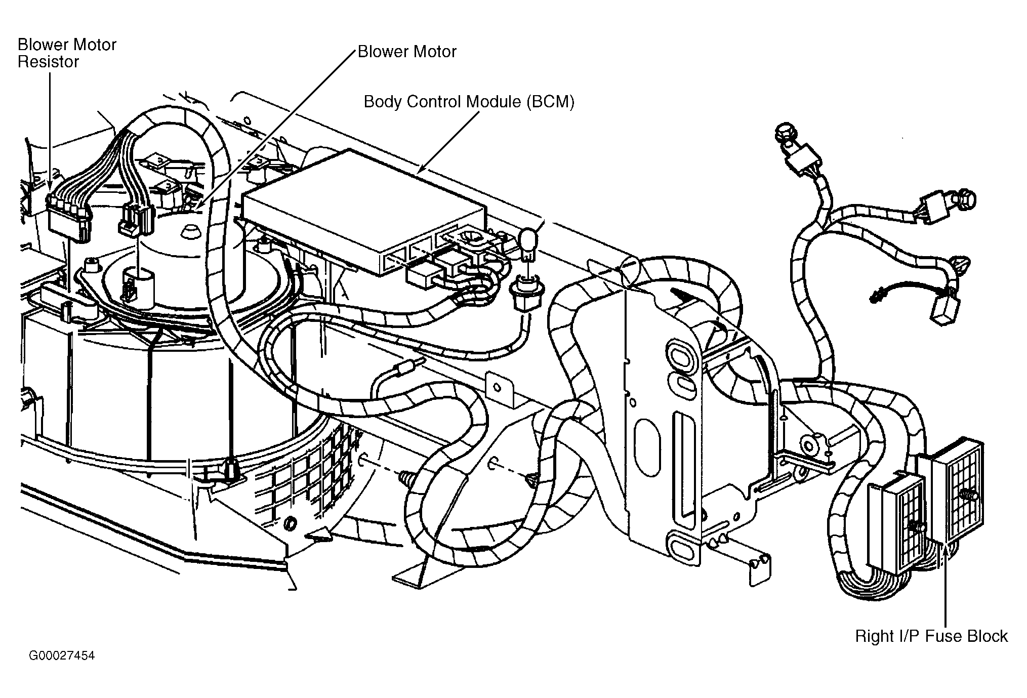

The heater fan has lost low speeds / only high works could this be the switch or the fan its self?

you need a speed control resister for the blower motor

The blower motor is fine other wise it won't be operating on high speed your culprit here 90% of the time is the blower motor resistor.

I have same car. Had same thing happen to me. Easy fix, get resistor. it is up under the dash on the passenger side. It has 4 sets of resistance so the one or two that get the hottest burn out first. There is one screw that I couldn't get back in after replacement, but it works fine without it. That is a common problen so evryone has the part.

Jerry Z thanks for your reply, i think that i might have the same issue as you....could you tell me exactly under the dash board is that located. I cant find it and picture would be wonderful and a part number. Thanks a bunch.

I'm having the same issue, and was wondering if anyone could reply to the last post, with the pn and exact location.

Below right side of dash
