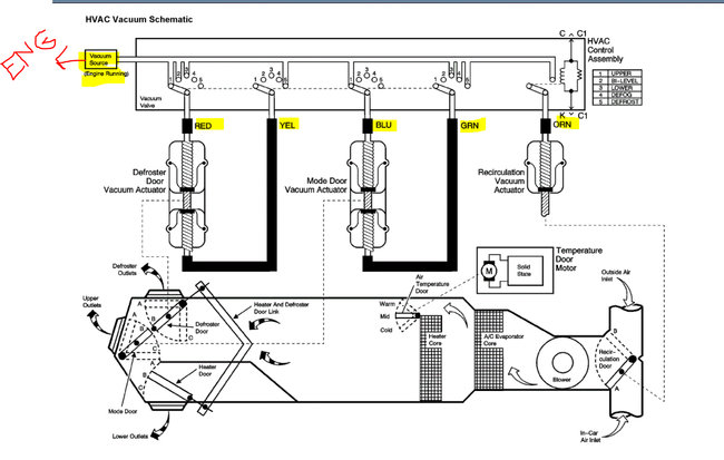

How do you reconnect the vacuum lines for the heater control switch? I was trying to replace my radio and thought I had to take that out and I pulled on the wire and hoses I hear air and now I don't have heat it's freezing out. any ideas 2005 Oldsmobile Alero?
Jan 21, 2022 at 7:23 PM
  • 110,194 POSTS

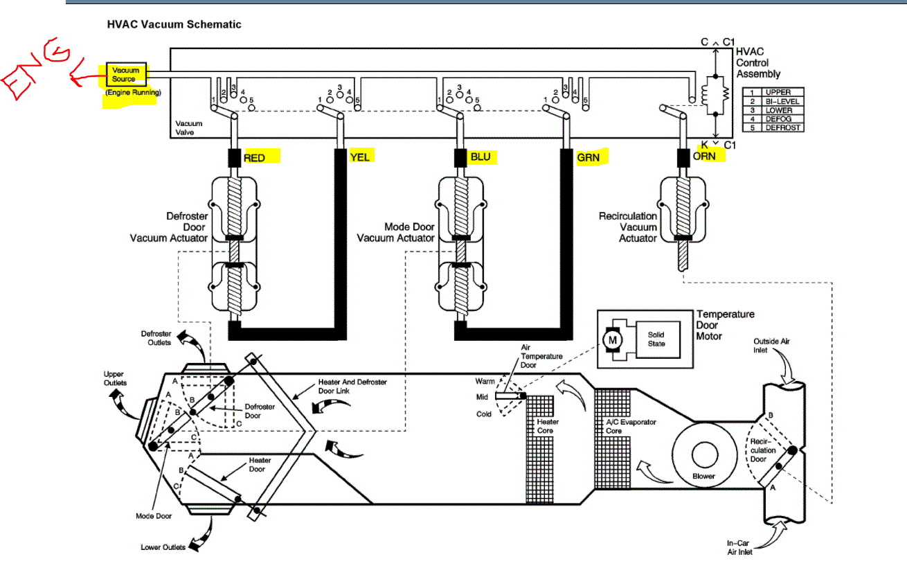

On the rear of the controller, you will see where the vacuum hoses attach. The hoses are identified by color.
Pic 1 below shows how they attach to the rear of the controller. The arrow I added is the vacuum supply from the engine.
The bottom of the pic indicates where the hoses go. Take a look through this and let me know if this helps.
